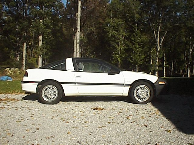

What I did a few years ago to a talon was just do the 97+ eclipse bumpers and lights and leave the top black. It can look very nice this way. Heres an example I found of a 95 talon with 97+ bumpers,sideskirts,and lights. Notice how he retains the stock top and wing.

What front is that on the white/black talon/ converted eclipse?

MILKMAN wrote:What front is that on the white/black talon/ converted eclipse?
Its just a stock 97-99 eclipse bumper like somebody said though I just noticed it does have a black rmdsm (sp?) lip on the very bottom of it. And a bigass front mount of course.
