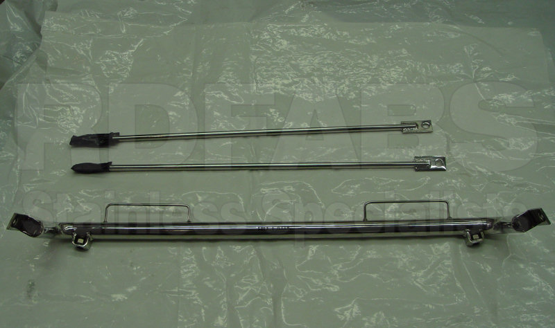

Possible injury point: Buy some prebent 90* round stock. You'll increase the aesthetics of the bar and completely eliminate the possibility of injury if someone accidentally bumps into that point.
Put a gusset in here: It'll greatly increase chassis support. More chassis support/bracing > .000001lb of aluminum weight increase.
Grind all these edges: It will increase aesthetics and wont draw blood if someone scrapes a body part on it.
Sharp, unground edges = unfinished.

I dont have a bar because i dont need one yetb but i'll show you a proper bar.

They are not being sold anymore due to them not being DOT approved and RD Fabs not wanting to be liable in the event of a car accident. Same thing you'll run into when someone gets hurt with your bar.
