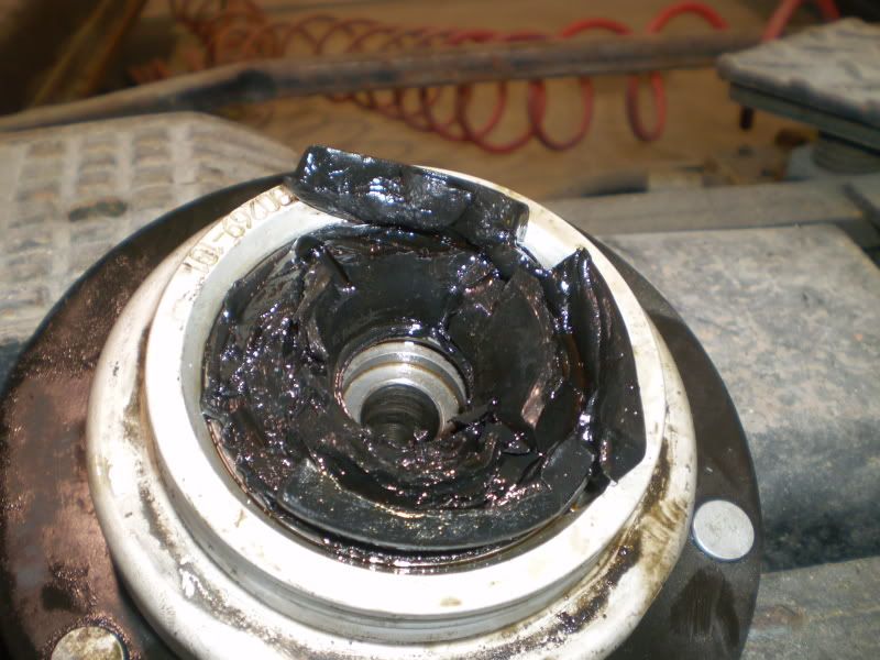

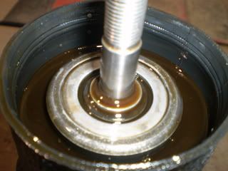

well yesturday the strut just quite on my and here are some pics of went happened to the strut.
this is what came out of the strut.
this is the upper part of the bag plate .
and the strut leaking and wont go back up.
i have only been driving on this for 5 months.
