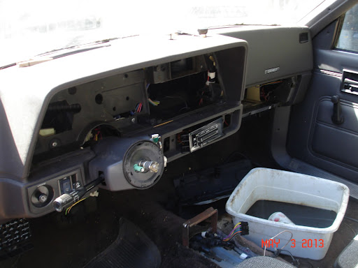

Got most every thing off today. Took me about 5 hours and of that 2 were spent on removing the rear bumper. I keep it stored about 15 miles from my house so as usual I forgot something ( PB Blaster) so the six bolts on the rear bumper were tough. The body has really taken a beating sitting outside on the bare ground and rust is really starting to eat this car up. The paint is also getting spider cracks and is starting to peel.
One thing left to get is the headlight switch and bezel.
DOES ANYONE KNOW HOW TO GET THE headlight KNOB OFF?

John, there is a small metal tab on the back side of the knob. You might have to turn the knob around to feel it. Use a small screw driver or a pick and press the tab towards you and also pull the knob towards you - off it comes!!

Thanks Orlen,
Didn't have a flashlight with me and tried several small allen wrenches in that hole. So I will push that very small metal tab away from the dash board and towards me as I sit in the drivers seat?

Exactly John!! I destroyed my first one out of frustration only to feel so foolish after seeing how it was done. That little tab acts as a kinda spring tensioner to keep the knob on, but just slides on when they installed it at the factory.

Exactly what I didn't want to do. I had that frustration and destroy at any cost just get the knob off feeling so I just stopped.

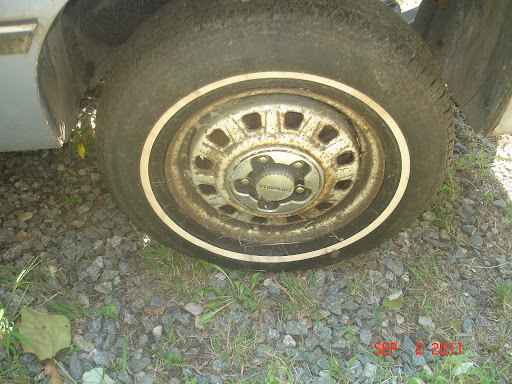

I see Chevrolet mud flaps!! Can you save them for me? And some of the better lug nuts too, Please

No problem, Factory lugs are in ok shape!
