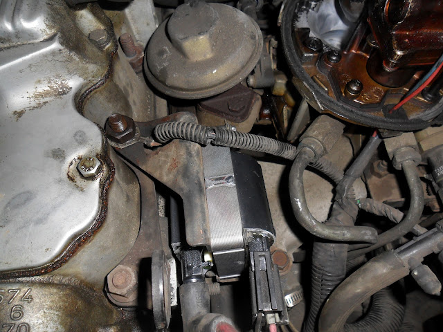

Got the Coil today, and the install was a breeze. ....a what? You fellow OHV owners ask? I fully understand & feel your pain folks!! I have a small show & tell for the both sides to see. As all OHV owners well know, just finding the coil is the beginning to a long frustrating ordeal. Buried UNDER the intake and blocked by the distributor - this beast is a disaster in design. It is on par with the OHC starter design - you just gotta ask "why on earth???"
So, here is the location of the OHC coil - (OHV owner please try not to drool :-O)
Secured by one bolt & one nut (arrows) , the hardest part is removing the air cleaner assembly!

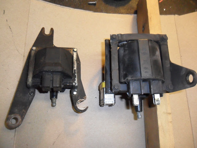

Here is a neat comparison of the OHV & OHC coils side by side. (OHV is on left)
Now this part might finally make the poor OHV owner break down. After all the trouble to find that coil. all the troubles to remove that darn thing , they got to cut off the pins holding this mess together before they can even replace the coil to the mount. Here, on the OHC design - 4 5.5mm bolts and the coil comes right off the mount, and right back together.....I know OHV'ers....it just isn't fair, is it!! And after all you've gone through, now you got to fit this darn thing back up under the intak manifold!! CURSES!!
