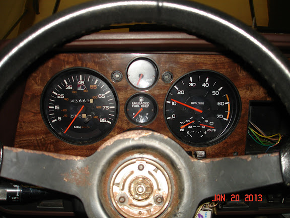

If he removed the horn plate there should be two bolt holes that he can screw the remover into. He may need to add washers/spacers to get enough thread on the removal bolt to work.
With the horn plate removed.
With the horn plate installed.
I have removed three or four 1 st gen wheels with this cheapo removal tool. Sometimes the rental places will rent tools that work on newer models.

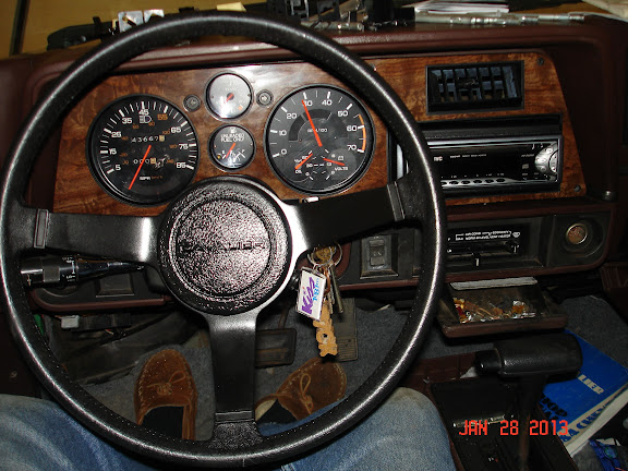

And with the horn button on and complete.
