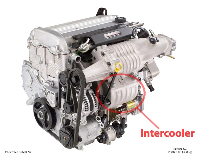

hey a kid around me just bought a new colbalt ss and i seen that its intercooled, isnt the supercharger basically the same as the gm s/c for the 2.4 engine so how is the colbalt supercharger being intercooled?
No it's not the same charger. It is still a roots type though.
how did you" see it was intercooled"? there is no front mount, you werelooking at the rad. It is air to water intercooled via a laminova heat exchanger located in the engine bay.

if it was the radiator it looks like a intercooler to me, real thin and long so i dont know
it bolts inbetween the head and the SC if I am not mistaken and is cooled by coolant
LE61T PTE6262 Powered
its a air to water intercooler , or aftercooler , heat exchanger as some call them
Aftercoolers and Intercoolers are essentially the same thing, it just depends on what the manufacturer wants to call it. I've seen an Aftercooler on a John Deere turbo-diesel that is in the exact same location as an Intercooler on a Cummins turbo-diesel engine.

Yes, it is generally done something like this (note: not a j-body kit):
And those lines on the side of the intercooler are hooked up to a water pump that runs to a heat exchanger mounted in the front of the car in the path of air.

that is a tibby intake for the s/c kit from alpine , ive seen several of those
lol
[quote=97cavie24ls(JDM cav sedan™)]that is a tibby intake for the s/c kit from alpine , ive seen several of those
lol
*ding ding ding*
Woot. Yeah, very sexy little kit if you ask me, but it gives a great example on how to intercool a supercharger setup.
