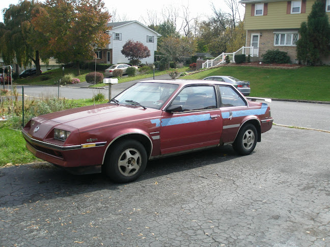

Same color as my 86 I had back in the day. Mine was a custom, must be down a level from yours because mine was no where as nice inside. Mine also had a lot more rust. We used to call it the $hithawk. Best car for $300 / 5 months ever.
That color interior is not one I think I have seen in the junkyarding I have done.Car looks pretty nice being the age and looks straight to me.Tired after trucking so keeping it short.
It appears re markably good in these photos. And quite stock and complete. GREAT FIND! Where is the rust/
Best of luck with the project- we have all too few skyhawks and firenzas
(Quoting a past member)-"Never underestimate a First Gen"
This is a "limited" which was above the trim level of "custom"; it seems to have every option except for the 2.0 engine and a cruise control.

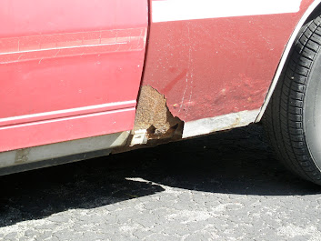

and some of the rust (I also removed a silver "plate" across the bottom of the doors, something I always called a water catcher/rust creator

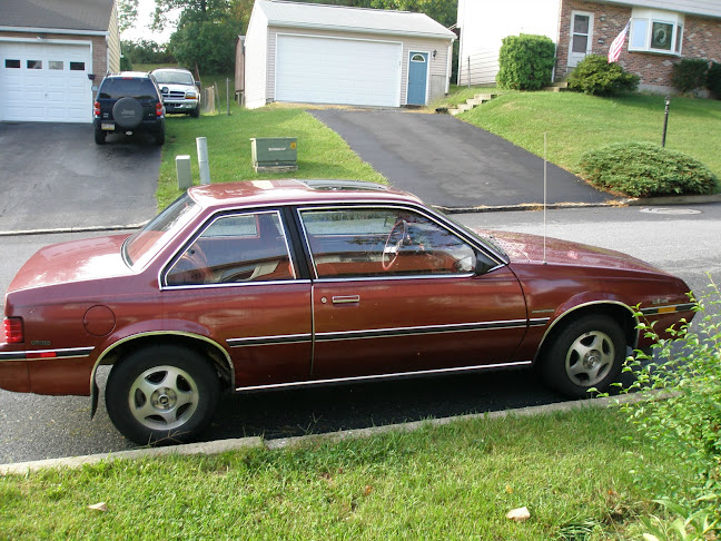

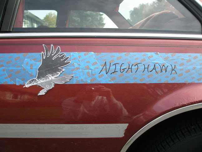

Wanted to get a better idea of what the car will look like when painted, so I used some tape to make the stripe, and yeah, it looks even better in my head when it is all done! The car will be black, with a silver stripe. The hawk will be black with a silver border.
the stripe will stop and meet with the fender vents
not sure yet if I'm going to use the 70s style Hawk graphic or an 80s style one, but here's the 70s Hawk
the stripe is going to go over the top of the spoiler and down the other side as well
